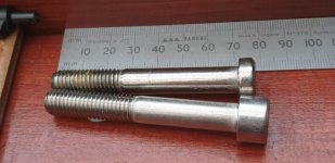

Right, that said, removing these bolts is tricky. The head thickness and therefore the depth of the hex hole is shallow - there is a picture below showing the BRP bolt next to a standard hex bolt, note the head depth.
Because the head depth is shallow and because the bolts are very effectively glued in place there will be some bruising of the hex due to the force necessary to turn the bolt, consequently your technique needs to be very good.

Yes, I do that. They are not quite a neat in appearance because they stand a little proud of the bar recess and often have their characteristics stamped on the top edge. I have a machine shop so I skim the top and add a wee chamfer so appearance for me is fine. The standard hex bolt also has an 8mm hex which is a good deal stronger in drive terms.
