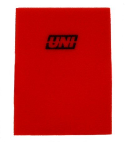

First, you need a glass canister fuel filter. These come in various configurations. Some come with the tubing nipples molded in. Others come with the nipples separate (they screw in). I actually prefer the separate nipples because there isn't a lot of distance to the stock air box and I simply put the hose on over the hex portion of the filter end and clamped them there. Works great.
The ends unscrew so you can access the interior screen. You want to remove the fuel filter element and replace it with a chunk of this;
UNI Bulk, Coarse, Open Cell Foam Air Filter Sheet
If you email or PM me. I will send you a chunk of this so you don't have to purchase a full sheet. Or, you can find this on the Internet or at most off road motorcycle/ATV shops. The one I use is 3/8" thick. That works very well in this setup. You want to pretty much fill the cavity with this foam. But the foam needs to be just enough to fill the cavity. You DO NOT want to compress the foam, which will defeat the purpose of the foam. Leave about 1/4" of free space at the top of the filter glass.
There isn't a lot of room between the stock air box and the crank case vent port. This filter takes up most of the room. You will need very short hose connections between each end of the filter and their respective connections. The picture provided of this setup is with the JT custom air box which gives you more room to work with.
You will also need 2 small hose clamps for each end of the filter. These come in several versions. Most any will do.
