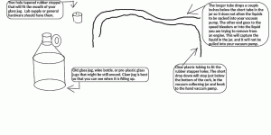

The hand vacuum pump is $25 at Harbor Freight. That plus the cost of a can of the best brake fluid you can find.
And enough clear plastic tubing so that you can sit side of the master cylinder and keep it filled full enough that no air bubbles get sucked into the lines while you are pulling the new fluid into the brake lines.
This is basically what I use with the hand brake bleeder pump. You could just use a quart Mason jar with the tubing epoxied into the lid. I use a half gallon clear glass jug. Sometimes have to remove over-filled oil in small engines, or pull some other over-filled liquid out of something. The catch jar is just to drop the liquid into and prevent it from being sucked into the little hand pump. With the larger jug, you can suck engine oil out of small gas engines for people who have put a quart or more too much oil in them.
You can build the catch jar for less that $5, or maybe for free if you have the tubing and stoppers laying around.
