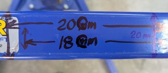

@Peter Aawen makes complete sense. So, the bit on the left gets flipped upside down and bolted to the bit on the right with four bolts, to provide a flat surface for the front of the Spyder frame to rest on?
@Flier Tuck if you could provide a reference or pics, that would be a great help. You're saying the two parts get bolted together as described above, then the whole thing gets slid back and forth along the BB arm until the semi-circular cutout aligns with a reference point, depending on the model of Spyder being lifted?

At this point the instructions get a little vague. They say to remove the right floorboard (okay) then slide the lift under the bike from the right side, without mentioning there's not enough clearance.
Align the BB main lift arm with the bike's spine and position the rear mount under the bike's "rear suspension arm". I think that, from the pictures they mean the rear shock bottom mounting bracket. Once done, raise the rear mount pillar, then fit the two u-bolts around them. This requires more space than would be available without having raised the bike considerably, I think.
For the first few attempts to raise and lower the lift, I opted to do so manually. This gave me better understanding of how the machine would list and/or roll and allowed for me to stop quickly and drop the lift and perform any slight adjustments below. I always raise the machine manually until I know that the full weight of the machine is on the front and rear mounts before I install the side bracket mount to the floorboard socket. Be sure to use the floorboard mount but be sure you're not tightening it to the floorboard sockets too soon, or you'll risk bending the bracket itself by putting too much weight of the machine on that bracket. The entire weight of the bike should be on the front and rear lift mounts; the side mount is intended to prevent the machine from tilting away from the lift. Once I have the side mount bracket secured (I also use a 1/2 spacer washer here) I use my power drill for the rest of the ride. For the rear cradle, check to make sure that the cradle pillar is not unscrewed so far that it causes the pillar to tilt. The entire process is a bit nerve-wracking until you get the hang of what movement to expect before the entire unit settles in and becomes stabilized. But I'm pretty sure you've trialed and errored all of this by now.I just purchased a 24 S2S. I also purchased a new Big Blue lift, put it together followed the directions, and went to lift the bike up. As you can see in the pic, the left side won't lift. The right tire is up around 2 5/8 of an inch and the rear is up around 2 7/8 of an inch. I am centered in the front and in the back the bike is a little wobbly, nothing crazy. The front mount is right at the edge as per the instructions and the rear mount is at 13/16 of an inch as per the instructions or 20mm. If anyone with this lift has any advice, I would be grateful.

That is what they say to do, you're right. I've been doing that wrong.For the first few attempts to raise and lower the lift, I opted to do so manually. This gave me better understanding of how the machine would list and/or roll and allowed for me to stop quickly and drop the lift and perform any slight adjustments below. I always raise the machine manually until I know that the full weight of the machine is on the front and rear mounts before I install the side bracket mount to the floorboard socket.
That is happening. Also, it tends to shift the BB back away from the bike, misaligning it with the spine when that happens. I'll go back and start from scratch. Thanks.Be sure to use the floorboard mount but be sure you're not tightening it to the floorboard sockets too soon, or you'll risk bending the bracket itself by putting too much weight of the machine on that bracket.
It does, that's true. Back to the drawing board...The entire weight of the bike should be on the front and rear lift mounts; the side mount is intended to prevent the machine from tilting away from the lift.
